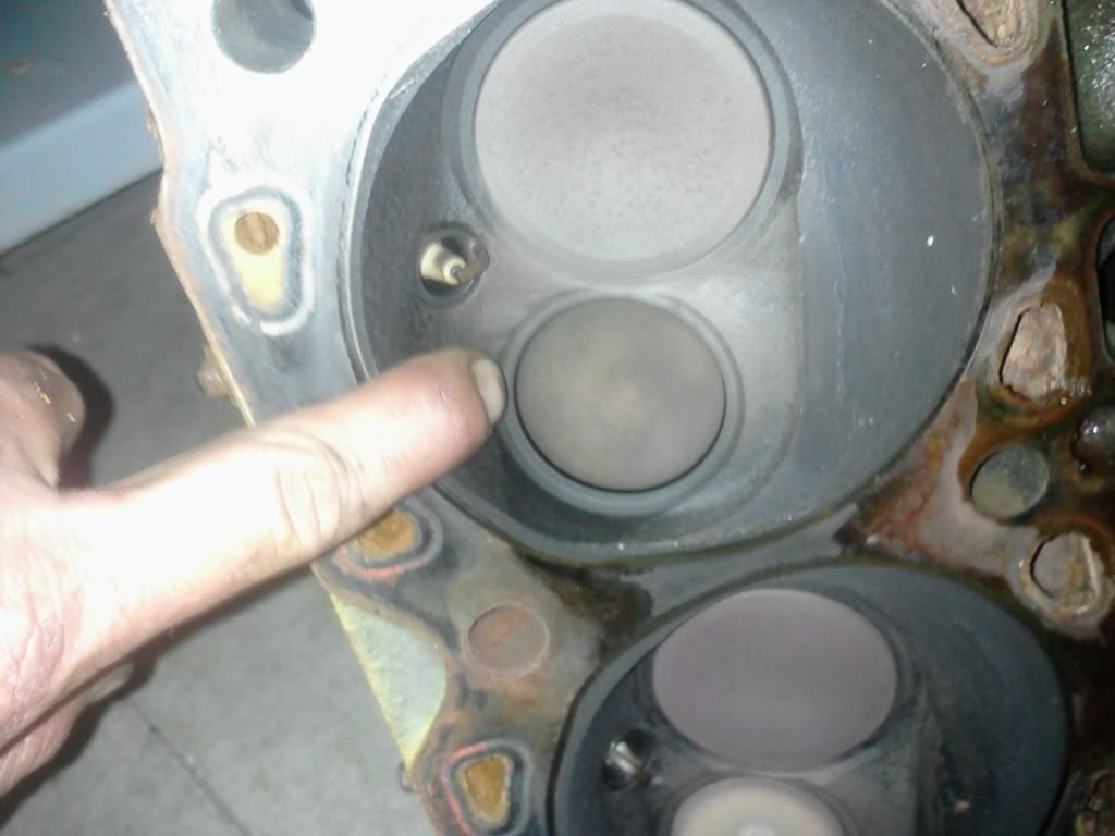

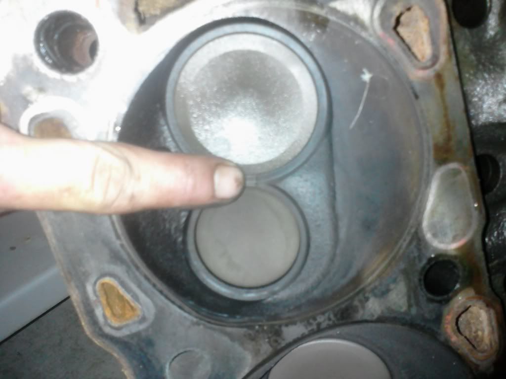

Well it's definitely a problem in the heads. Below are some pictures of the cracks he found.

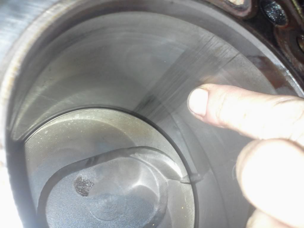

He also found heavy scoring at the 2 o'clock on the number 1 cylinder.
jroberts88
well the scaring in the cylinder dont look that bad... if you run your fingernail over it does it drag? does it feel deep?

Not to bad at all with the scaring. We're bringing the heads to a machinist Brian knows and we'll get the word on whether or not the heads are repairable or not.
My guts say that I'll be looking for a set of D0VE-C heads real soon though.
duanehydro
those appear to be d3 heads, and max dish piston.... 8:1 460 stock...man i'd love to build an engine for that boat....I bet 10 more mph, and less fuel comsumption.... :smile30:
