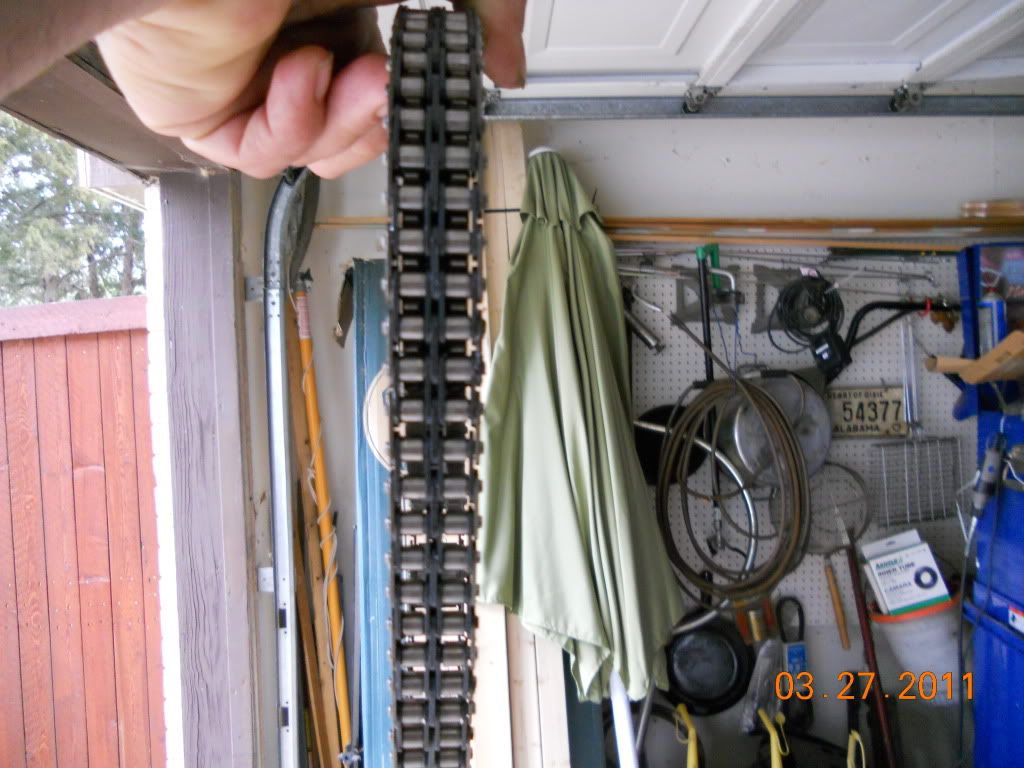

Found this post over on the Pontiac forum.
"The Melling 40408, Comp 3112, Speed Pro 224-3112, Cloyes "True Rolller" (with the 3112 in the part number) are all the same set. They're made by Cloyes. They come in different boxes. These are the "true roller" design with individual "seamless" rollers on each link."
And a pic of the Melling piece mine looks nothing like.
http://forums.performanceyears.com/forums/attachment.php?attachmentid=183914&d=1255289761
I have found part numbers for Pontiac from Comp of 2112 and 3112 but no 2212 like is stamped on my gear.  More evidence a cheap set was in my motor??????? :smile29:

Interesting that the part numbers in the post I found are supposedly all the same part just re-boxed.  At Summit, Melling $50, Comp $60 and Cloyes $106.  think.gif
KONA77
that is interesting....  i found that cloyes had many different price ranges and hopeful reflecting quality of there products than the others  think.gif

It's been confirmed.  Double row not true roller.  Check out the seams.  I'll be looking for the Melling piece local so I can put my hands on it before I buy it.
