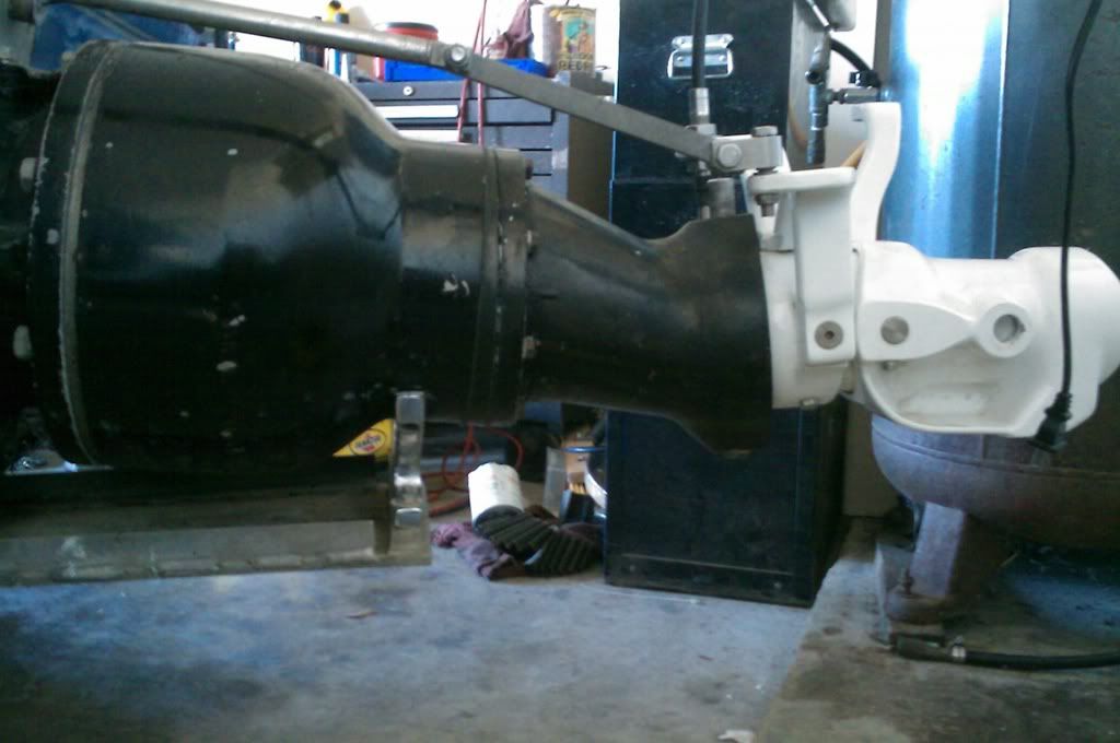

Here's some pictures of Bobbys pump
Crusader
Moderator
I just uploaded to photobucket and then copied the code and inserted it into the post. I didn't upload anything up to the site.

Thanks for the info turboed-tx-20. Did you look at the pics that were posted? So the wedge is in upside-down? I would think if I point the nozzle down with the wedge the the pressure would be pushing up on the back of the boat and push the front down?
