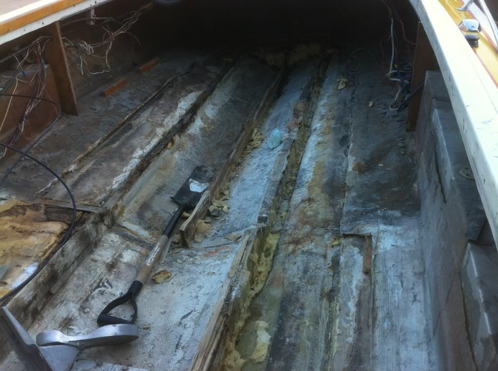

Here's a picture of the progress made this evening. I have to borrow my buddies saws all.

Believe it or not, I'm actually making progress. Another three hours on the job tonight yielded some results.
