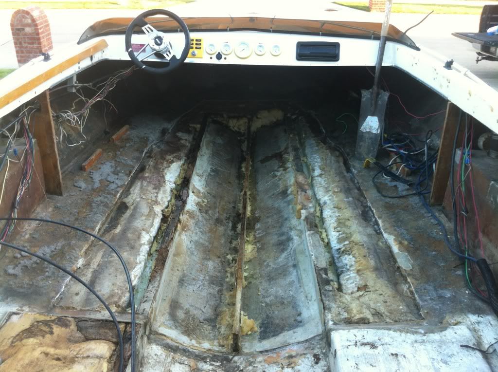

1 1/2 hours tonight and we made a little more progress.

I ordered a gallon of the floatation foam #2
http://www.aeromarineproducts.com/boat-foam.htm
Also ordered another 1 1/2 gallons of Epoxy.....about $50 cheaper than at West marine.

Crusader
Moderator
Last Mohican said:
Crusader said:
Anybody hear of "composite stringers"?? If so, where do you get them??
You could use some of those cardboard tubes that toilet paper comes on. Once they are glassed in they should be plenty strong for that blue oval power you have.  Maybe leave one square of paper on them to up the strength a little since that engine will be a fresh build.
Not really concerned with the weight reduction......I just don't ever want to have to do this crap again.....
As it is, Jacob has dibs on the Crusader when I kick the bucket (in the next five years according to him, lol) ....I don't want him to have to redo these stringers ever again..... lol.
I guess, based on his comments, shouldn't do anything to preserve the floors and just barely put them in so he has to replace them right after my schedule "kick off".....lol.
The kid is a little turkey, I swear. Lol.
blazeracer
What I did on mine was made a very efficient drain system under the floor. As long as the water gets out the wood will never rot either. The factory drains on mine were about the size of a pencil and probably had been plugged for years. You can use wood and it will last, just make sure the water can get out.
