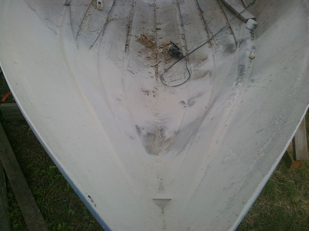

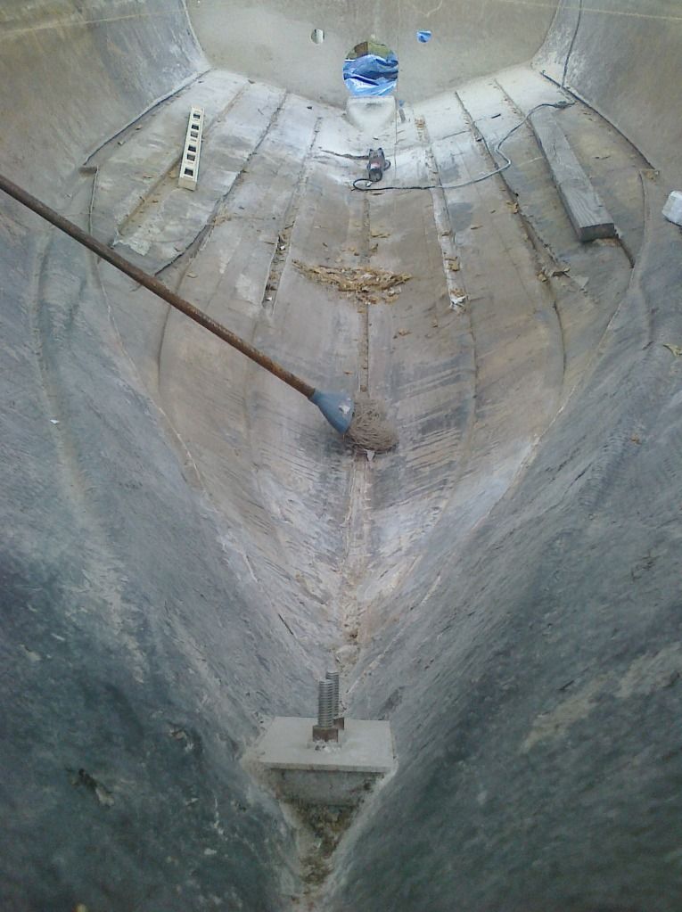

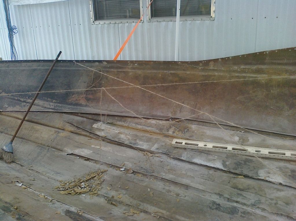

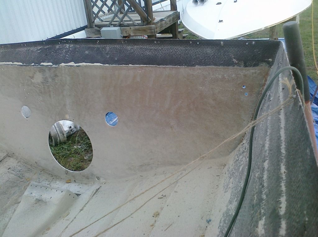

This weekends progress.  Got the support system for the hull done.  got the hull leveled and squared.  I had it all out of wack.  Now I should be able to glass everything up and have it straight.

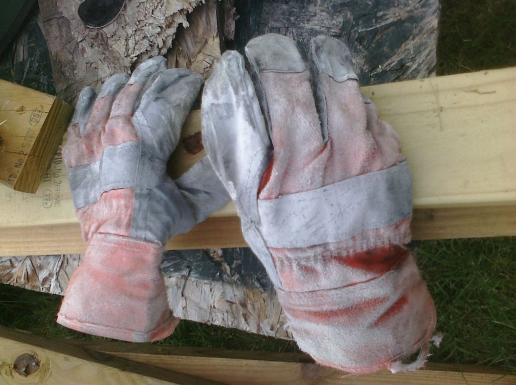

Here's what the gloves looked like after all the grinding.

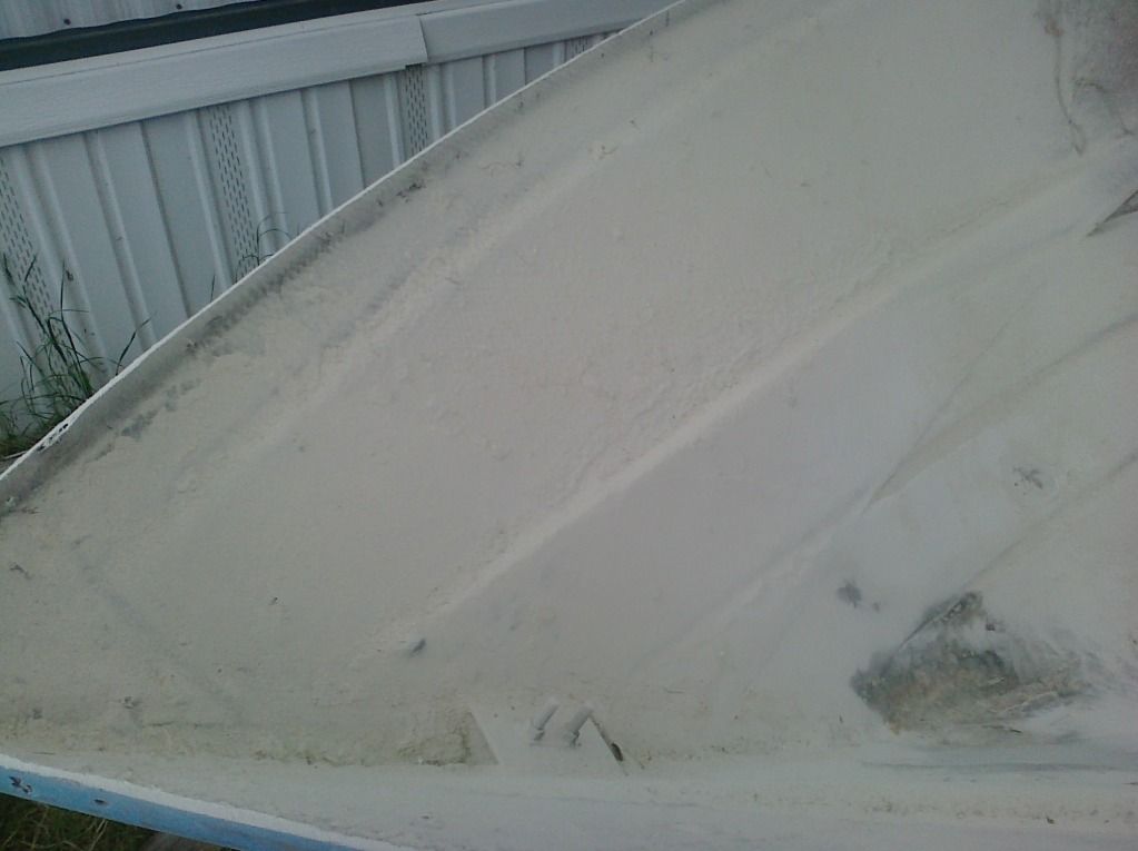

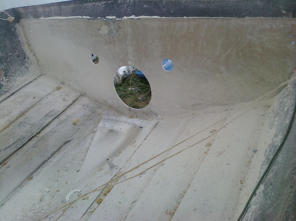

Some before shots
After shots ( notice all the white powder covering everything except where I was grinding and where my hands and knees were.

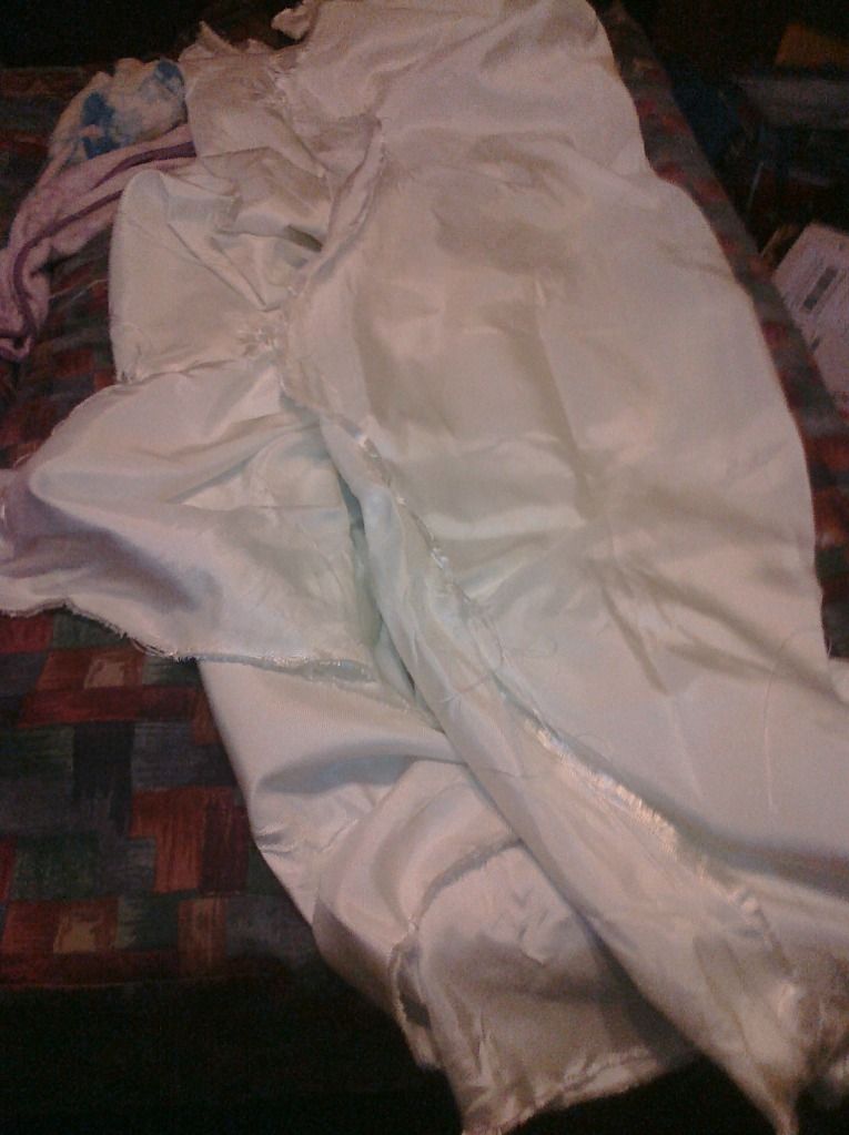

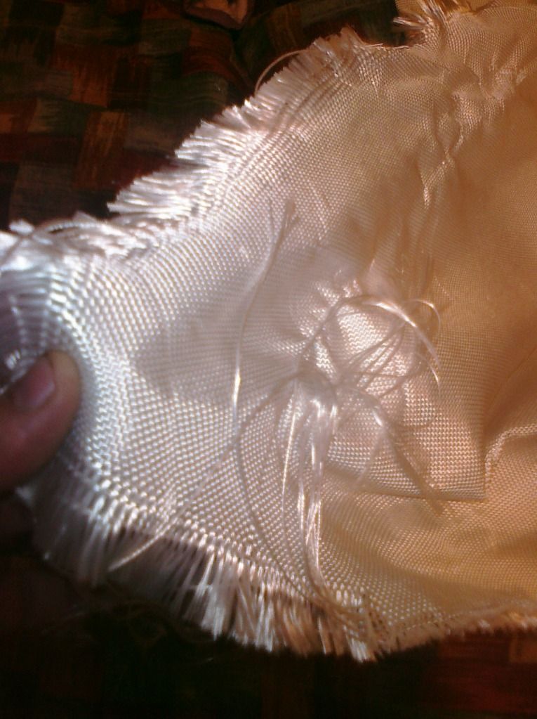

The cloth thats going back in

A lot more grinding to do though, found a bunch of areas with some bad glassing.  Seems like someone thought it was okay to put resin only and to allow air bubbles.  Not sure if it was previous owners or the factory.  Also found out all the Strakes/chines all had a wood supports glassed over one was rotted out the other 3 were all wet wood.  Not sure if I am going to put wood back in or use a resin/woodflour mix before glassing it over.  I know it was in there for support but not sure if it needs the flexibility of the wood or the resin is fine.
Also som idiot put screws in through the floor at some point and put them through the hull.  Had to drill those out so now I have more holes in my hull but I did that to remind me to patch them and as to where they are.  There was also a staple that was there and went through the hull too.
The intake/pump housing is cracked through so going to have to get that ground out and welded up.  Will have to figure out how to pull my impeller and wear ring.  Wear ring is grooved too will take more pics of that post up.  Hope it will be fine if not have to get a price on the one i know about in Michigan.
Anyways a good weekend of work.  Only thing I had go bad was that I got the trailer loaded up with all the aluminum and scrap and then got to the scrap yard as they were closing the gates.  Oh well I will have to drop that off this week.

John
ive been told that that woven glass mat there is not very good, delaminates easy, not trying to poop on your parade just passing on my limited knowledge
