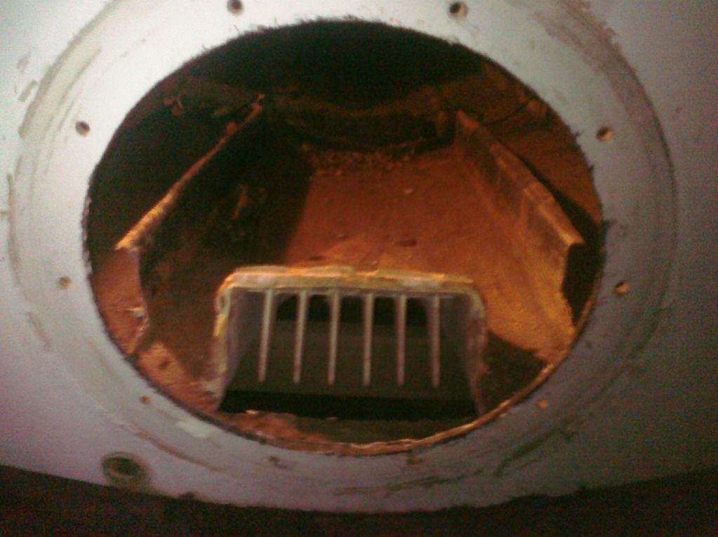

Work finally gettin done on the ChryslerJet
I cleaned it out, got the rest of the jet housing removed, removed the center stringer.  Tomorrow finish cutting out the old floor fiberglass and remove the foam in the bow so i can remove the remainder of the center stringer.  Then the next order of business is getting the new transom installed and the pump reinstalled.  Then onto the motor stringers, side and center stringers. but before those need to maxe sure the hull is straight and add bunk styled supports to the makeshift boat stands to keep the boat from getting a hook.  I don't want to be like Kona with a hooked hull. :smile30:

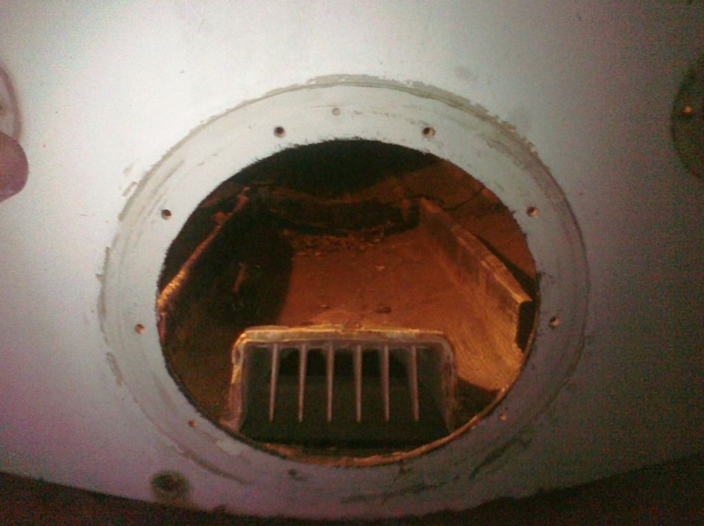

Here are some shots.  I finally got a good shot of the bump in the roof of the intake too.  Here is that shot first, you can see the bump behind the rock grate.  this is from the pump side after the pump was removed.

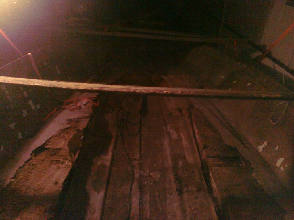

the cleaned hull
the old center stringer came out by just kicking it

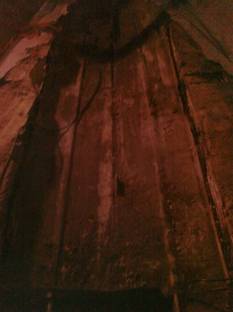

another shot of the cleaned hull

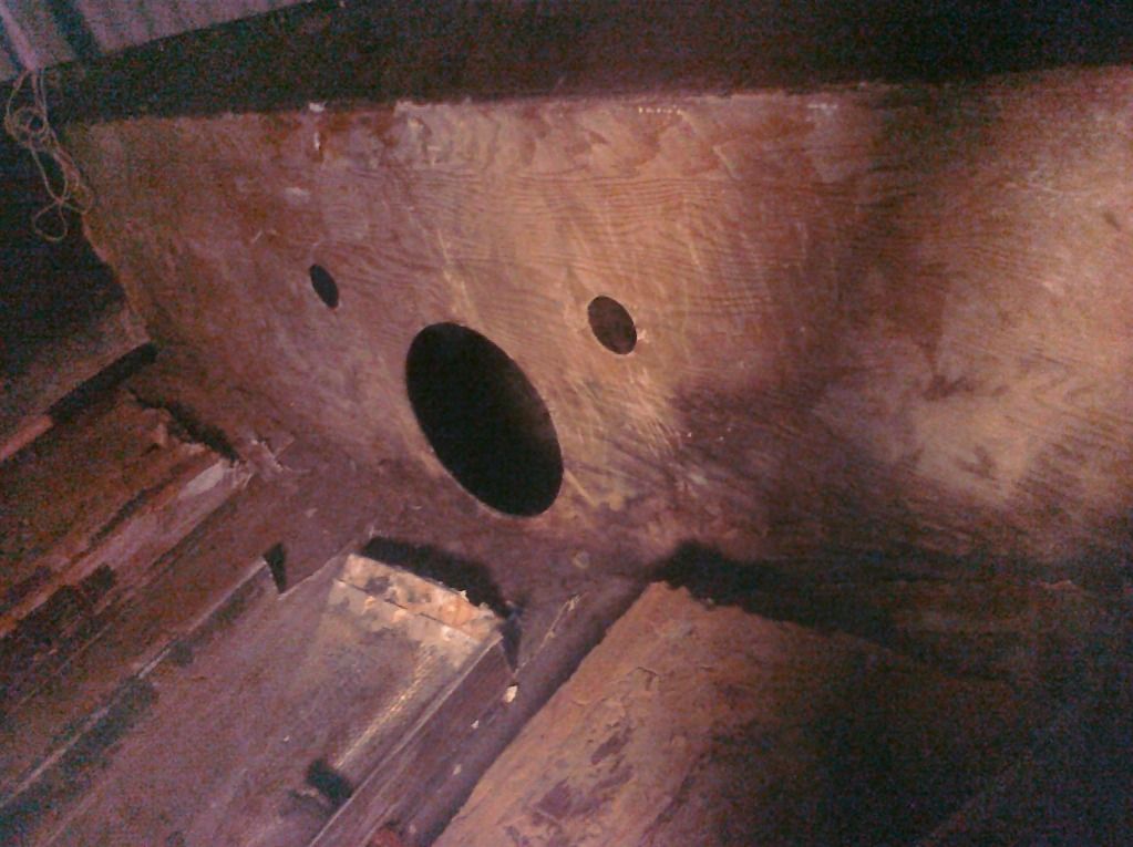

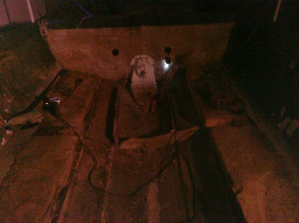

the missing pump and transom

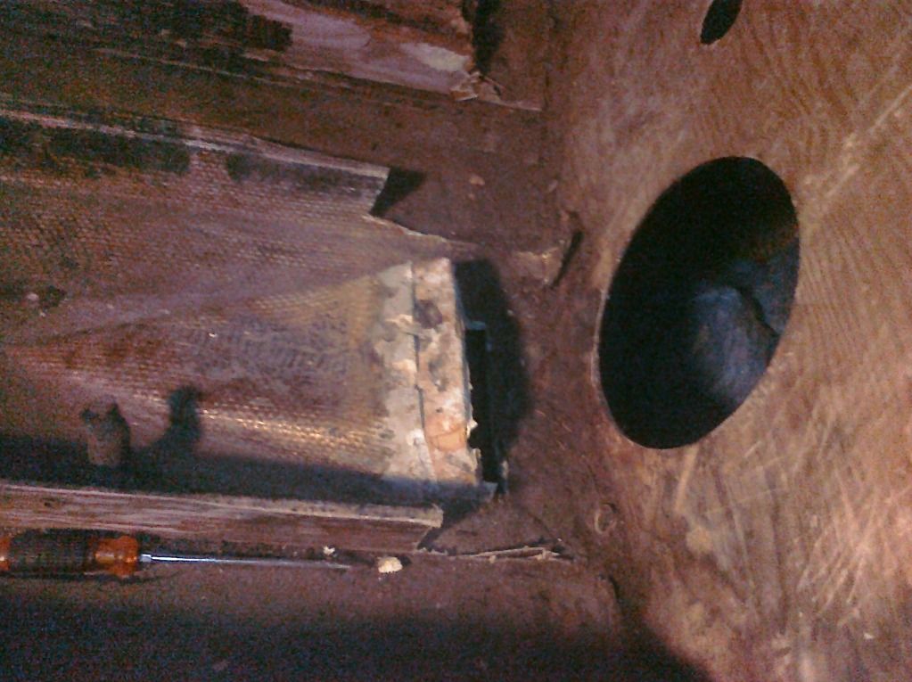

The hole in the transom for the pump

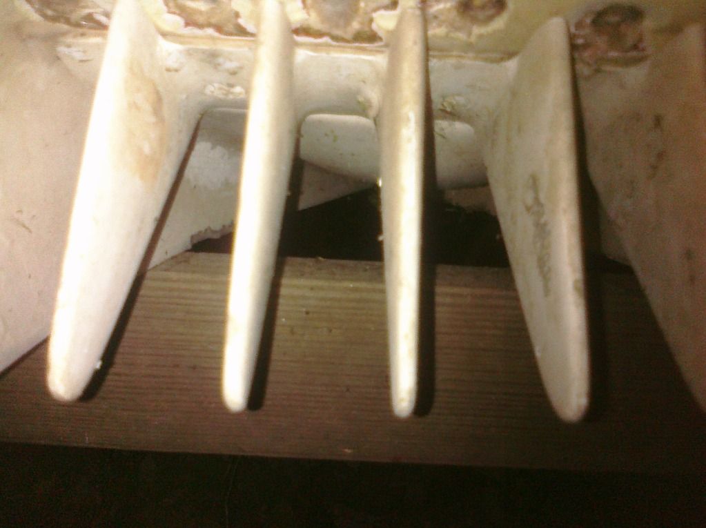

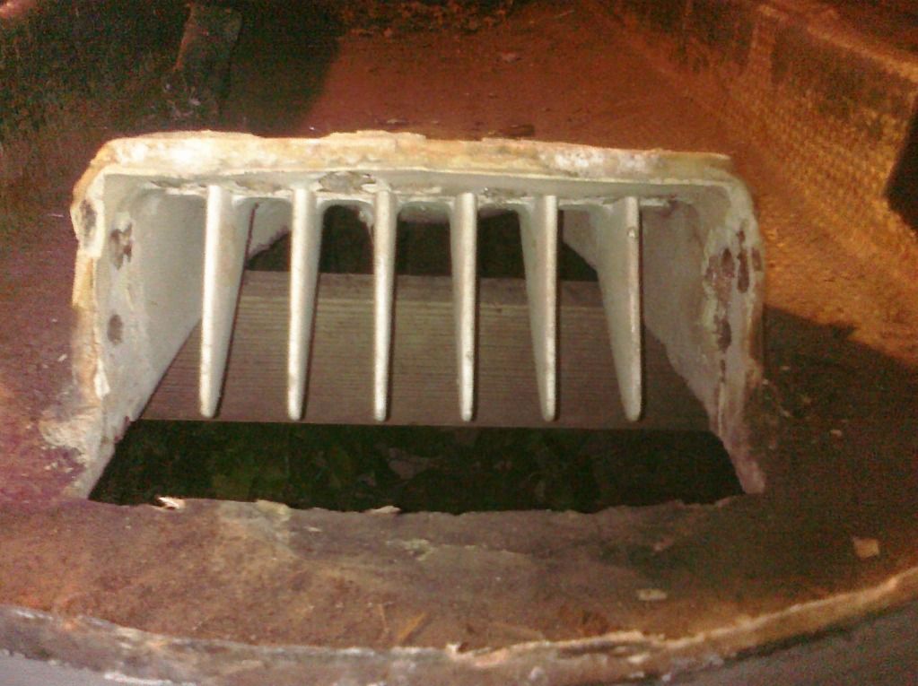

like the rock grate?

That intake looks mean doesn't it?
