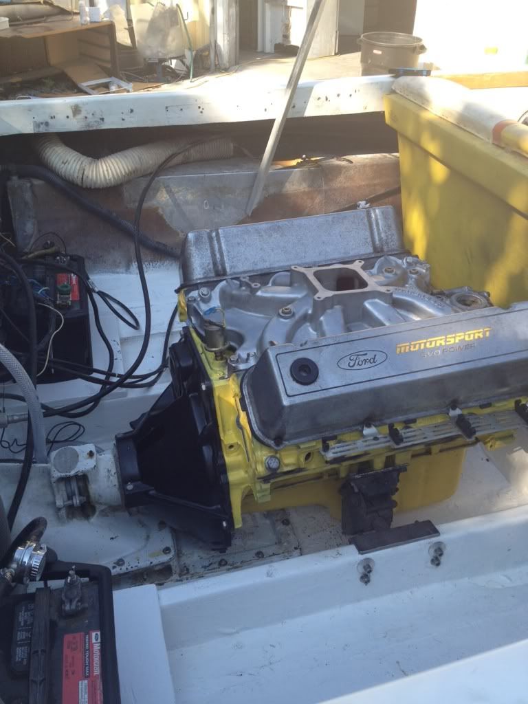

The second install this week.
Logs and carb bolted on and ready to wire. Notice James giving two "one finger" salutes in the background?? Lol

Patchman said:
Ya man, starting to look that way.
The starter is at Hammonds right now...the armature is bad. It was just rebuilt last spring......weird how it went bad in just a year.
Also...I just bought two Interstate Marine starting Batteries Group 27 so that should help with cranking that beast. The old batteries were Motorcraft auto batteries date stamped 2008....so it's about time they're replaced anyway. One of the old batteries read 8.5 volts (unloaded) last night and I know I charged that sucker two days prior.....no, they weren't connected to anything.
Hope to have all this mess resolved and in the lake Saturday or sunday.....fingers crossed.

With two brand new fresh group 27 Interstate Marine starting batteries and hopefully a rebuilt starter this afternoon, this puppy should fire up today!

Well, thanks to a 3rd party helping and wiring in the dark it turned out plug wires 7 and 8 were switched. Fixed them and it popped right off and purred like a kitten, oil pressure steady at 70 psi. GTG.
Ya she did!!
I didn't get the camera out in time to film the first light off.....but all I can say is "schwing"!!!!!!! Lol.
Can't wait to break in the cam tomorrow....tool around a bit, then hit pebble beach Sunday!!!
