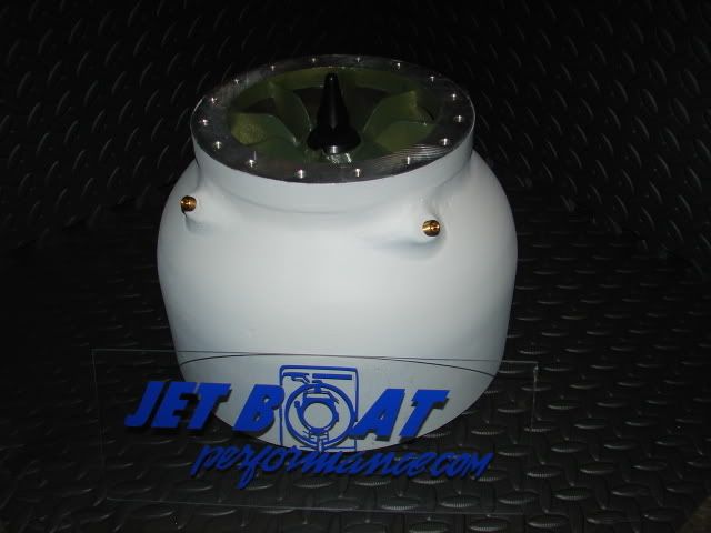

Basically E and F pumps (Transom mount) are what we call "insert jets they require a mold insert in the hull during layup, they were very popular at the middle 70's and into the eighties, they were quick and simple to rig and work well , popular in Taylors, Glastrons etc most parts ,with the exception of suction piece and steering components will readily swap between most Berks and thier "Clones", the only real difference between E and F is that the F had a gimble "affair" that allowed for Trim (jet-ovater) A,B,C,J and Gs  (standard "drop thru intake types") are all very similar as well , some early A and a few B's have a longer shaft and different designs at the bearing cap, rear bearing seal (none) and The Suction its self , All split bowls will swap and the G is considered the best for the ability to accept bolt ons and "flow". We (JBP and others) are now producing a modified "C" split bowl however that we belive will out flow the G as we know it. (PHOTOS BELOW)

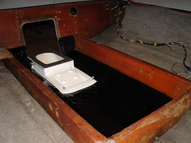

Just curious could someone run thru the proper way to install an intake,I took one out of one boat to install in another any help would be appreciated.Thanks Steve

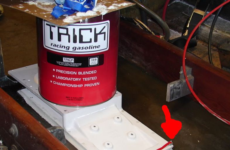

Happy to help with this we set an intake a week or so Call if Josh or I can help or I will post up pics of the work for ya ! Tom
sm3childers
Thanks Tom,some more pics would be great.I guess what I need to know is it necessary to shim under the intake to get a certain degree ont the top of the intake? The one I took off they had a few washers under the front corners and then just epoxied them in.The hole in the new boat fits good it just seems like the front of the intake hangs a little low under the boat,mabey this is why they shimmed the other one?  Steve
we drill and tap the 4 corners for bolts from the top and let them be "levelers" ,then measure a dozen times and "bed" once , then once "bedded" in epoxy (and just as the epoxy "kicks') which is a couple beers  :smile13: we back the levelers out and fill the leveler holes  with epoxy , at dead level (keel) your intake should be at 4 to 5* depending on a multitude of different things (whos and what intake what hull etc) more info when you can , but thats a start you guys can always call , always happy to help ! Tom
